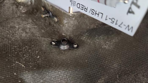

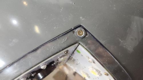

Countersunk the lens where the screw goes in, and used a tinnerman washier to install it. One screw on each side of the lens.
Nut plate on the inside
Screw and tinnerman washer to hold the lens in place.
