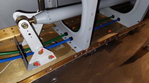

I ran the plastic tubing of the pitot and AOA lines through the wing ribs. I needed to make sure they did not contact the rotating parts of the bellcrank, so previously I installed ClickBond anchors. I used the Grip Lock Ties that have rubber strips that act as a cuxhion so there will be no plastic-on-plastic rubbing and possibly cutting into the tubing.
Plumbing installed.
Plumbing installed.

Using the ties to hold down the tubing so they don't contact the bellcrank
