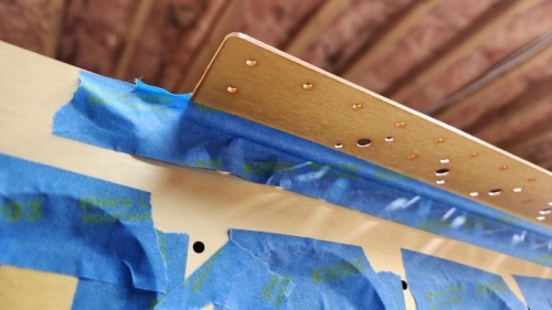

LEFT spar - Platenuts
Started countersinking the spar flanges for the platenuts that will secure the wing fuel tanks to the spar.
As suggested by others, I put blue painter's tape over any overlapping parts where aluminum chips could get caught.
Tape to protect crevices
Countersinking the holes
Duburred underside of spar flange holes
