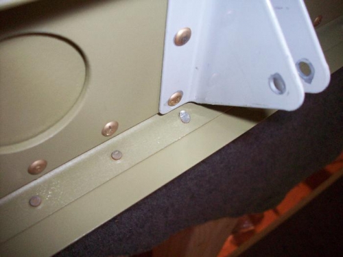

Decent progress tonight, but I bent over two rivets that hold the skin onto the rear spar. The rivets are really close to the rudder brackets as shown in the 3rd. pic, and the squeezer could only reach 3/4 of the rivet so it ended up pushing the shop head over. They'll be drilled out during the next session.

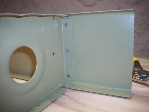

Just before the skin goes on.

Riveting the rear spar, I'll need to drill out two of these that I bent over.
