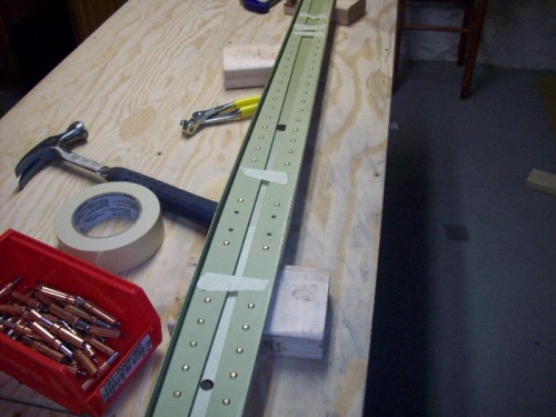

Brief Description:  Began to rivet the rear spar
Began riveting the rear spar of the HS today. I thought that the rivets were too long, but after doing some research I learned that the shop head diameter gauge is a minimum diameter gauge, and a little over is ok.

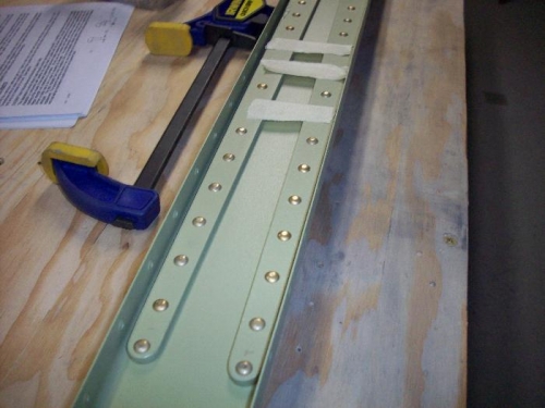

HS-609PP's riveted to rear spar assy.

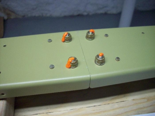

Torqued nuts to 25 in lb, then applied torque seal.
