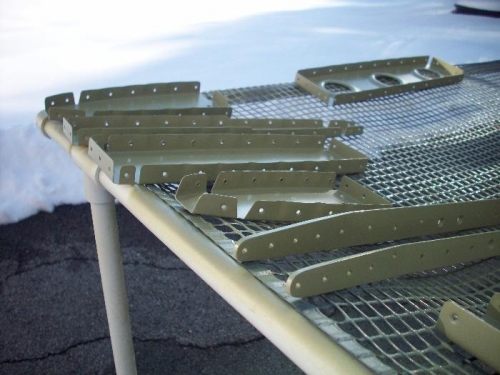

Took advantage of the nice day, after receiving 8" of snow, to get outside and prime the HS parts. I took my time, measured primer and activator, waited 30 minutes and began. The HVLP gun took a little playing with to dial in the spray, but once there spraying was a snap. Made the mistake of flipping over too early on a couple of parts. I had to go back and touch up as I left a couple of finger prints. I'm happy with the way they look, now I can get on to assembling in a couple of days.
Primed HS parts on the frame that I built.
