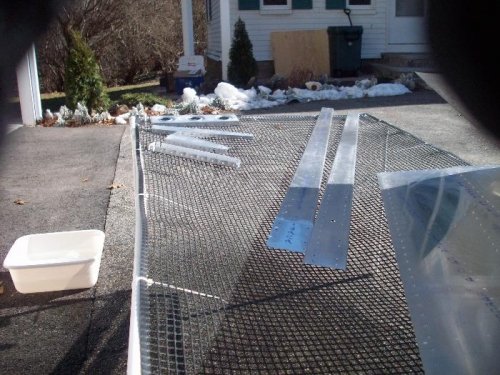

Finally got a couple of hours free to get outside and use some of the clear weather to my advantage. I used alumiprep and alodine on the HS parts, and then set them aside for priming in a couple of days, when I get some more time outside. I need to get a larger/wider bucket for the alodine as I wasn't able to fully submerge some of the HS parts. I bathed them with a clean rag, but the longer parts didn't become as brown as the shorter/smaller parts.

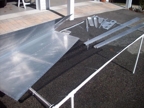

The frame that I built to hold the parts for drying.
Another shot of the HS parts.
