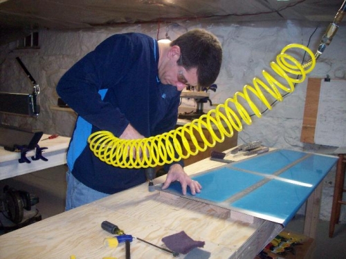

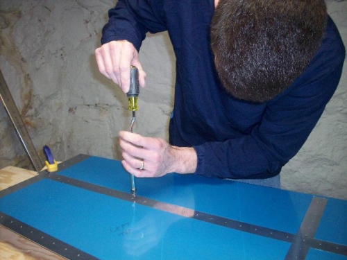

Brief Description:  Debur the rivet holes in the HS skins
Continued to work on the HS skins. Deburr the holes, then scotchbrite and sand everything so it's smooth to the touch. Don't want any sharp edges, corners, burrs, etc.
Deburring the holes
Deburring the holes
Using the scotchbrite wheel on the air drill to smooth the edges.
