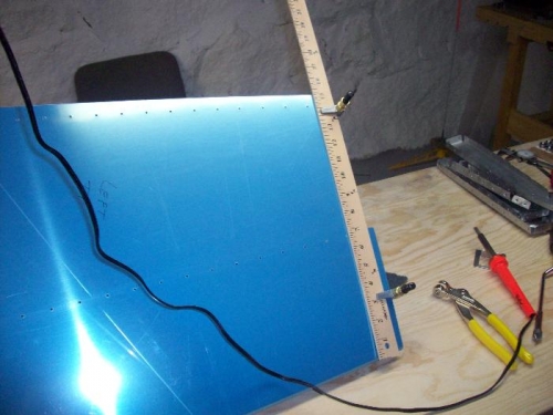

Brief Description:  Used a soldering iron to remove the plastic around
Used a soldering iron to remove the plastic from the rivet holes. Went pretty smooth, with no issues. Make sure the soldering tip is very smooth so that it doesn't scratch the skins.
Yard stick in place for a straight melt edge

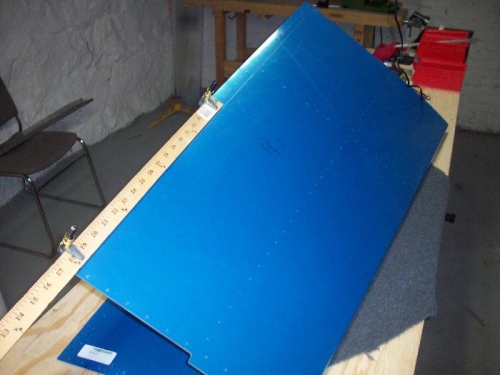

Left and right HS skins with rivet plastic removed
