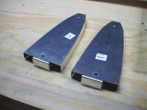

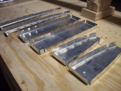

Notched the HS-404 left and right ribs to fit between HS-810-1 and HS-814-1. Also began fluting HS-(706, 707, and 708) They were slightly bowed, so it didn't take much to get them flat again. We don't flute HS-404 and HS-405 as the attach holes to HS-801PP are not yet known.
Marked aft end of HS-404 left and right.
Notched aft end of HS-404 left and right.
Fluted HS-(706, 707, and 708 ribs)  Don't flute HS-404, and 504 at this point.
