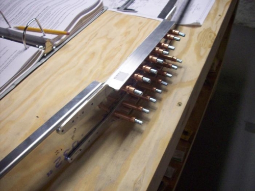

Made some decent progress with the front spar. Match drilled, bent to 6 degrees, and re-assembled to check the fit before moving on.
Cleco HS-702 to HS-810-1 and HS-814-1 then match drill per the plans

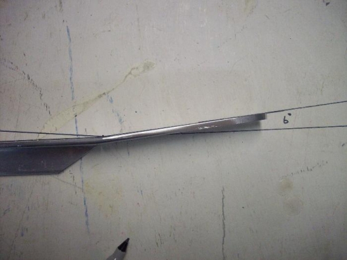

Bend the tabs of HS-810-1 and HS-814-1 to 6 degrees after radiusing the ends to 1/4
Bend the tabs of HS-810-1 and HS-814-1 to 6 degrees after radiusing the ends to 1/4"
After bending to 6 degrees.
