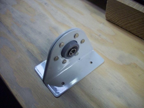

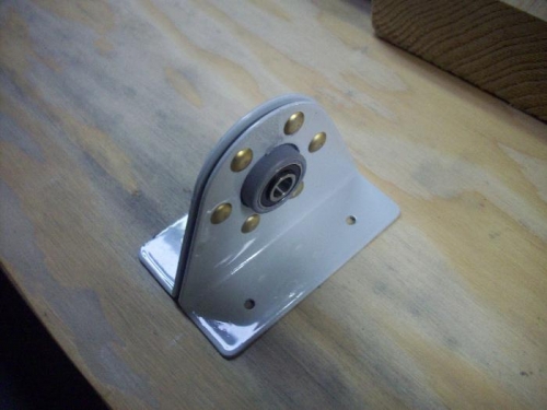

Manual Reference:  VA-146 Assembly
Brief Description:  Primed and rivet together the VA-146 Assembly
Used some NAPA self etching primer to prime VA-146 after carefully taping off the bearing. Riveted together with the rivet squeezer. I installed an adjustable squeezer assembly into the squeezer which made dialing in the correct "squeeze" much easier.
Assembled VA-146
Assembled VA-146

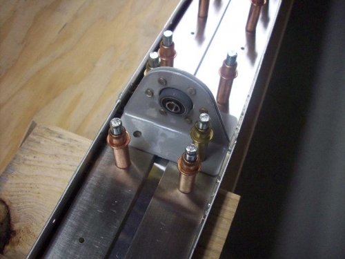

Cleco'd in place for match drilling
