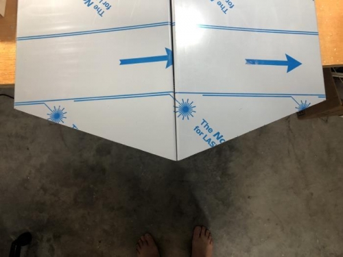

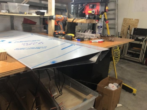

Cut Inside Ruddervator Skip
Cut R & L ruddervator skins to 45 9/32 on long end. Short end is -4 3/8 or 20 degrees.
This was done using dremel diamond cutting blade.
