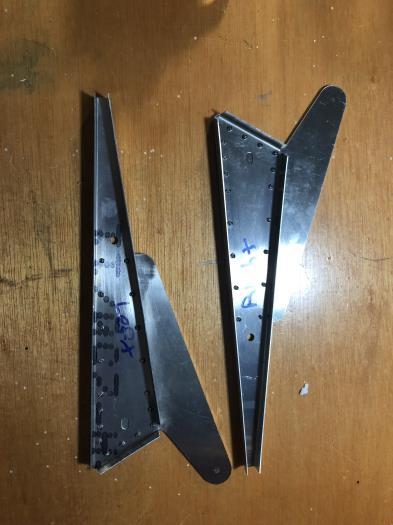

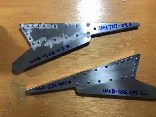

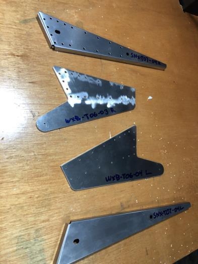

Drive Plate, Root Rib Assy
Updrilled RH & LH Drive Plate (WXB-T06-04) and Root Rib (SNX-T07-04).
Deburred, sanded and riveted 18x2 CCP-42 rivets.
Update 9/16: These were the wrong rivets! They sb CCC-444. The rivets have been removed
