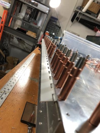

Brief Description:  RH Stab Hinge Fitting and Drilling
While the drilling only took about 10 minutes, the alignment to over an hour to get set correctly.
The plans called for the center of the hinge barrell be lined up with the edge of the skin and rear spar channel. These .49 cent clamps helped tremendously.
Once drilled, the ruddervator hinge was connected and moved up and down freely. The hinge pin also moves in and out very easily.
The drilled hinge has been deburred and polished.
Alignment of Hinge
Alignment of Hinge
