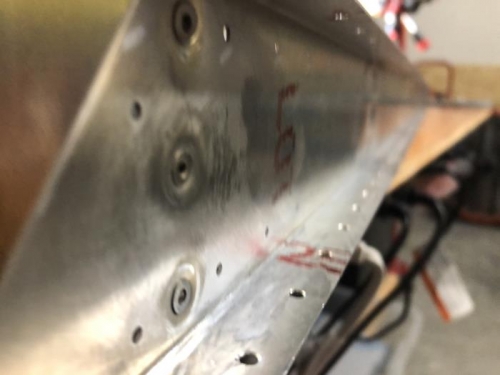

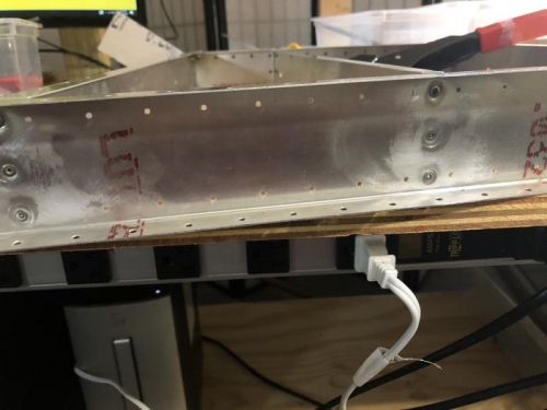

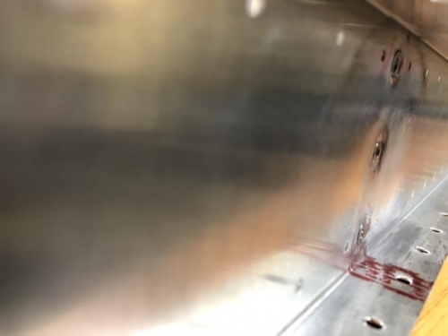

Brief Description:  Dimpled Rivets on RH & LH Stab
On the aft part of the stabs, the drawing requires 3 sets of flush rivets (CCC-42) on each. This is for the rear spars that are attached to the stabs when they are attached to the fuse.
Had to do a few over cause the dimles where not deep enough.
These are now as flat as their surface and should not create any space between the spars and the spar channels.
