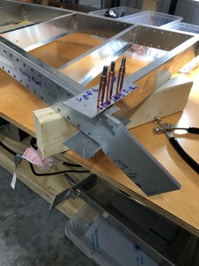

Brief Description:  LH STAB ASSEMBLY
1. Using the skin, i created a Jig for the Clip, Spar Junction using the pilot holes on the skin. It worked like a charm, allowing me to drill the clip holes precisely.
2, All holes on the skin have been updrilled except the spar-tip holes.
4. Rivited all remaining holes on the LH Stab frame.
Junction From Hell
Junction From Hell
