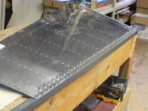

Brief Description:  Sealed the Trailing edge
I applied sealant to the trailing edge of the rudder wedge piece and the skin and then assembled. I then cleco'd the entire aseembley to the the metal angle. This is the recommended way to get a straight edge on the trailing edge of the rudder, according to Vans and all others that I have spoken with. It looks pretty straight now, well see whren I rivet it together in a few days.
All lined up ready for inspection!
