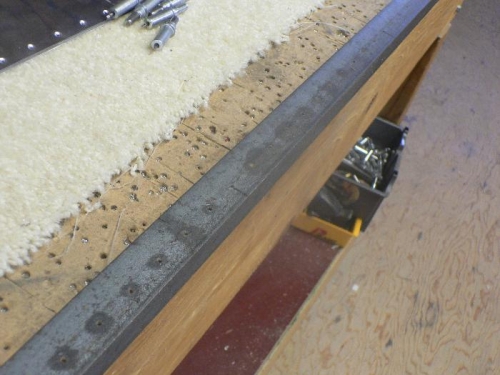

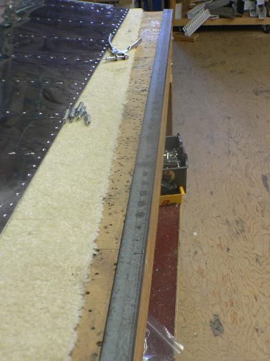

Prepared to seal the trailing edge together. I purchased a 6ft lenght of Steel angle and screwed oit to my work bench. I then I drilled holes in the angle to match the trailing edge of the rudder. This took awhile, but the drill press made it a little easier.
