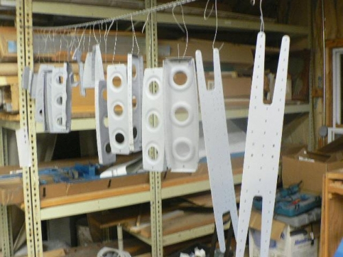

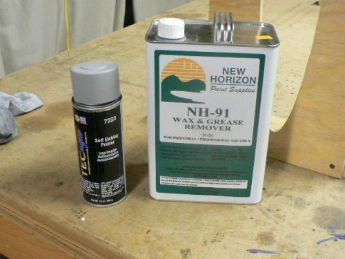

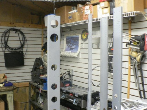

Primed all the HS parts today. I scuffed the parts with "Scotch Brite" and cleaned them with Wax and Grease remover. I then sprayed the parts with NAPA 7220 "Self Etching Primer"
The parts look great hanging on the drying line.
