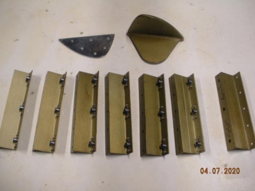

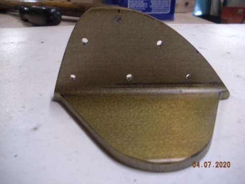

Brief Description:  R Fuel tank (Tank attach angle)
Fabricate the T-905 tank attach angle from stock angle aluminum as per the templates. Also, modify the T410 reinforcement plate. Match drill the inboard tank rib and T-410.
Deburr all parts and primer the T-905 angle as it mounts outside the fuel tank. Also, installed all platenuts onto the attach brackets as required.
