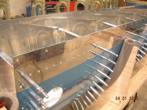

R. Fuel tank (Drill and CS.)
Match drilled all rivet holes. Countersink skin to baffle monting holes then mark all attach brackets and remove them and the baffle.
Skin to baffle holes counter sunk
