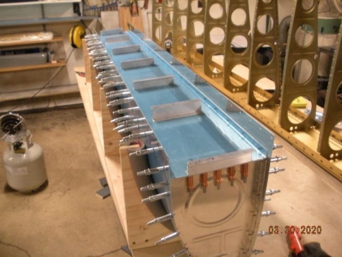

Brief Description:  R. Fuel tank. (Baffle & attach brackets)

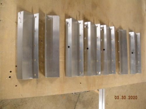

Finished installing all ribs. Used the W-932-DG drill guide to drill the T-912 attach angles.
Clecoe attanch brackets in place and match drill them to the Tank baffle. Lable all brackets
to reinstall in the same positions. Deburr attanch angles and Tank baffle. Install baffle into tank and clecoe in place. Temperary install attach angle in place with pop rivets as per plans.
Ready to install onto spar.
T-912 attach angles drilled
Ready to install onto main spar.
