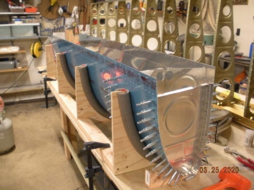

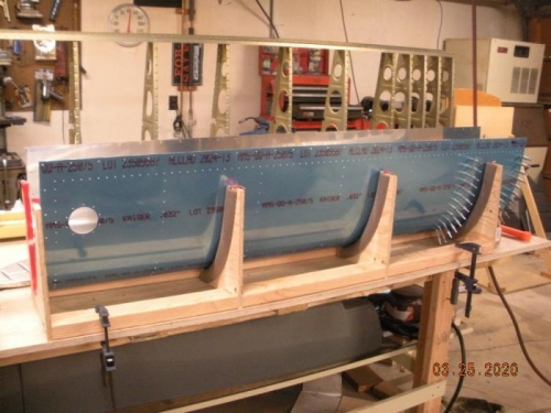

Finished straightening / Fluting / De-burring the fuel tank ribs. Removed the vinyl fron inside the T-901-R tank skin and installed it into the cradle. I had installed foam pipe insulation onto the cradle and it reallt helped to close the skin "Tighter" and make rib installation a lot easier.
R. Tank skin in the cradle
Installing ribs.
Installing ribs.
