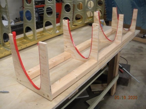

Removed and stored the bottom wing skins and began work on the leading edges. Traced around a leading edge rib and transfered it to a CAD drawing. Used the CNC router to create the cradle for assembling the leading edge. Used electrical tape to line the inside to protect the skin surface.
leading edge cradle.
