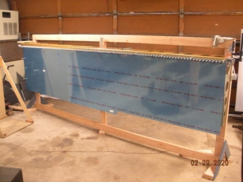

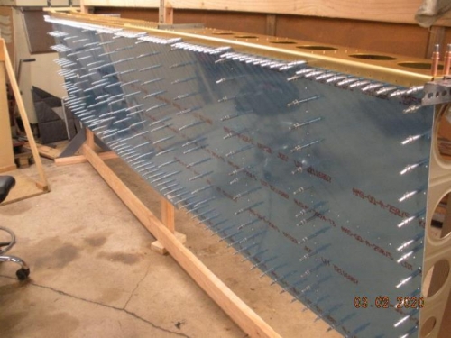

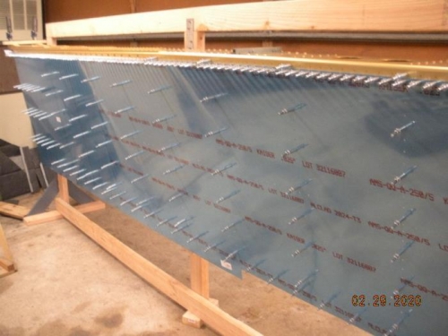

R.Wing skin prep
Match Drilled the L. and R. wing walk doublers and installed the Top skins on the R. side wing skeleton in the wing stand. Cleco to ribs and rear spar. Match drill all top skin mounting holes.
Top skins clecoed to the main spar
Aline and Cleco ribs and rear spar.
