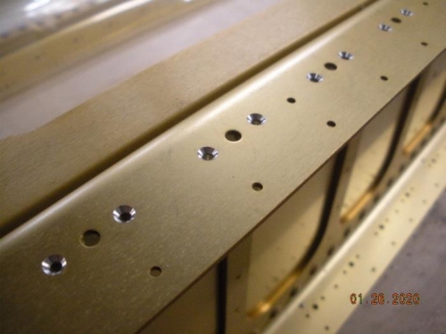

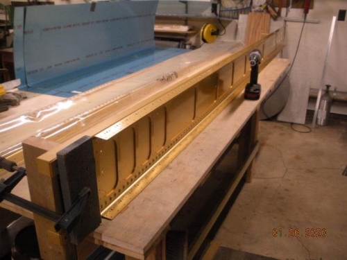

After getting things organized and stored away best i could, and studing the plans ansd drawings on Monday.... Began work on Tuesday.
Drilled, deburred, and CS all the rivet hole for the Spar platenuts. Did all the holes in both spars while the CS depth was set.
