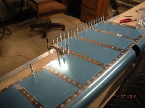

Applied VHB tape to the wedge and assembled into the trailing edge. Back riveted the trailing edge and installed the last rivets at the tip rib.
Marked and installed the mounting brackets for the electric trim servo onto the trim access cover plate. Dimpled the plate for the #6 mounting screws.
Trailing edge assembled
Finished... Straight as an arrow.
