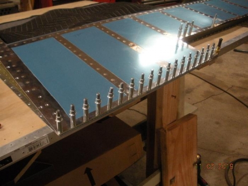

Riveted the E901 skin to the counterbalance assembly. The cut the aluminum wedge for the trailing edge to length. Marked and drilled the wedge using the holes in the skin as a guide and the "angle guide" i had made for the R. elevator. Disassembled and deburred all holes and dimpled the skin for flush rivets.
Counter sunk the wedge on both sides.
Riveting the counterbalance assembly
Trailing edge drilled
