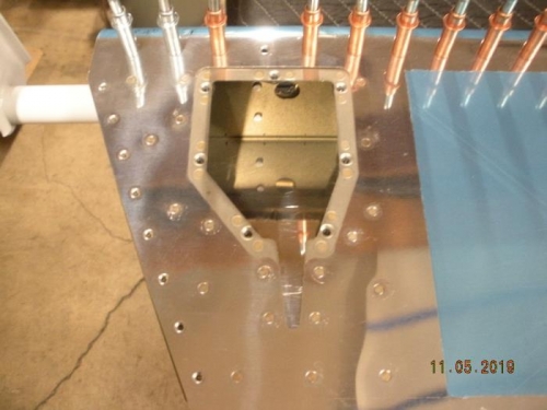

With help from my son, we got the top side of the 902 spar riveted to the skin. Once again, the special bucking bar i made for this purpaose worked excellent. Next, backriveted the lower stiffeners in place and the E-615PP trim opening reinforcement. Then, riveted the counterbalance sub-assembly to the spar.

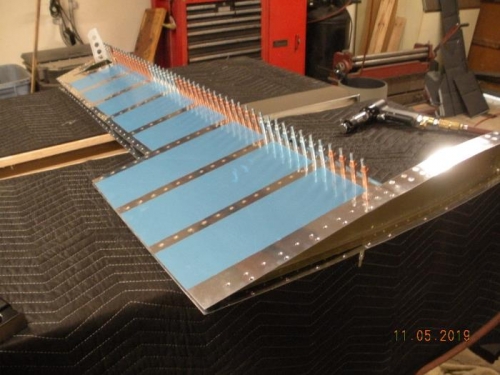

Clecoed the lower skin to spar. stopped there for the day.
Trim reinforcment plate
lower spar clecoed in place
