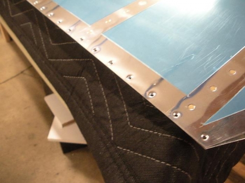

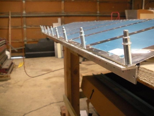

Began constructing the trailing adge of the R. elevator. Cut and "Match drill the "Wedge". Also match drill the Angle straight edge. Countersink the wedge on both sides and dimple the trailing edge skins.
match drilled wedge and angle straight edge
skins dimpled
