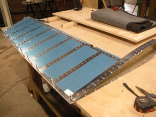

Date:  4-14-2019
Number of Hours:  4.50
Brief Description:  Right elevator cont.
