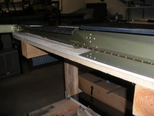

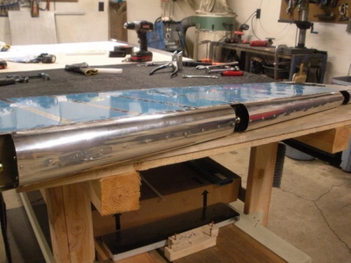

Rolling the leading edge was not to hard. Used a 1" steel pipe and because i was working alone, i rolled each section seperately.
After rolling had to do a bit of hand forming to get them a bit closer for riveting. A pain to get them cleco'd together. Installed the rod ends and adusted to specs. Torqued the jam nuts.
Rudder finished except for the fiberglass end caps.
