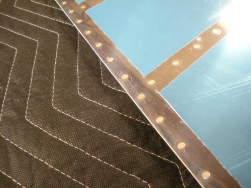

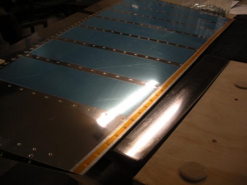

I've been dreading it, although i don't know why. Time to rivet the trailing edge.
Removed all the cleco's and the jig. The tape held the trailing edge very solid. Inserted rivets in all the holes and applied rivet tape the hold them in place.
Used my back rivet plate and back rivet set in the gun to work my way through all the rivets in the pattern recommended in the manual. Set them all about 3/4 of the way, checking to make sure the edge remained straight.
Then, flipped it over and used a "No mar" Mushroom set to finish the riveting on the back rivet plate.
Came out looking great. And WELL withing spec's for alinement.
trailing edge rivets
