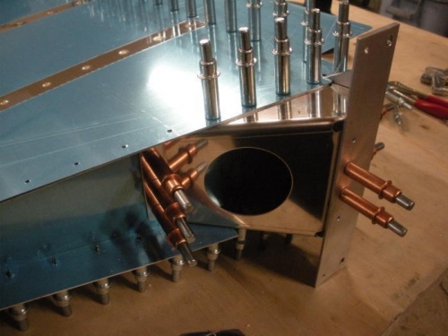

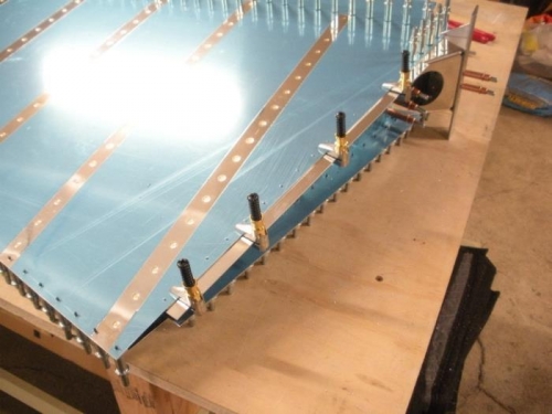

Finished final drilling of the R-901 skins. Then trimmed the R710 Rudder brace per the plans and installed. Fabricated the Bottom attach strips and match drilled to the bottom rib / skin.

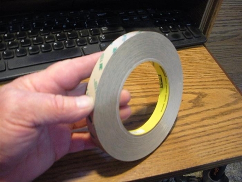

I decided to use 3m double sided tape on the trailing edge construction instead of the older "Fuel tank sealant" method. I've seen demonstrations of this tape before and the strenght is amazing.
So, I made a trip to Van's to buy a roll and i also picked up a small container of Tank sealant for use on the Trim tab construction later.
R710 installed and drilled
Installing the bottom attach strips
$28 a roll. But, enough for the whole plane
