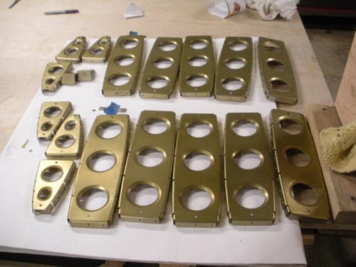

Last preperation step before final assembly begins. Primed all the HS parts using Sherman Williams Wash primer as per Vans recommendation.
Set up a screen at the end of my CNC cutting table. The table is ducted to a 30" exhaust fan for plasma cutting. Made a perfect "Down Draft" paint booth for small parts priming. Not a bit of overspray or fumes in the shop during the spraying.
