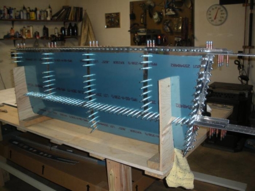

Date:  12-7-2018
Number of Hours:  7.00
Brief Description:  Left side HS
All clecoed together. Match drilled all the #40 holes and disassembled for deburring, dimpling, and counter sinking.
(NOTE: the 4th hole down on both sides of the main ribs was out of alinement just enough that a clecoe would not go in. Of course, "match drilling" fixed the issue. Just thought it was odd considering how well everything lines up.)
Left HS
Left HS
