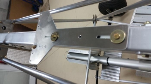

Step 25 is complete except the control rod needs to be bolted on as soon as the end eye bolts arrive which have now been reordered.

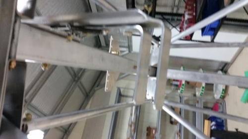

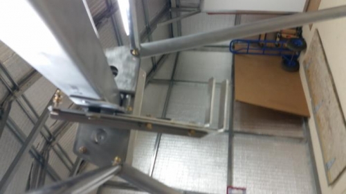

Because of a right shoulder issue, I have choosen to install the trim adjuster handle on the left side of the root tube. Accessing the handle from the front seat requires a long reach upward and rearword, which will be much easier using my left arm. It is nice to be able to adjust the aircraft to my personal advantages . . .
Trim adjuster handle installed
differential plate & slider installed

Installation on left side of root tube
