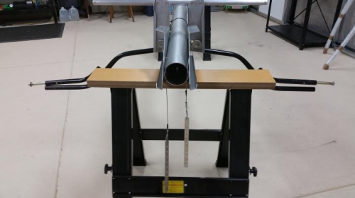

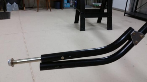

step 3
Installation of axle tubes
Instal axle tube on each side of the undercarrage spreader
Assemble 2 axle sleeves and axle inside of axle tube - drill through all three and pin with bolt
