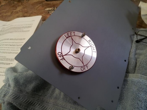

Measured for holes in fuel selector plate. Drilled two holes dia. .134 in plate and counter sunk for the oval head screws. This plate is kind of heavy, I'm now wondering if there is a better lighter way to do this.
