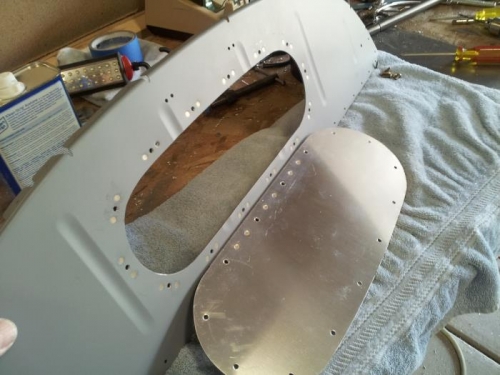

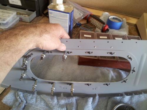

Brief Description:  Completed fab and install of bulkhead door
I transferred the holes from the door to the doubler and the bulkhead. c-sunk all platenut holes on the doubler and dimpled all holes on the bulkhead - deburred, primed the doubler. Riveted the entire assembly and clecoed to the fuselage for pictures. I will attach some additional pictures for the record.
