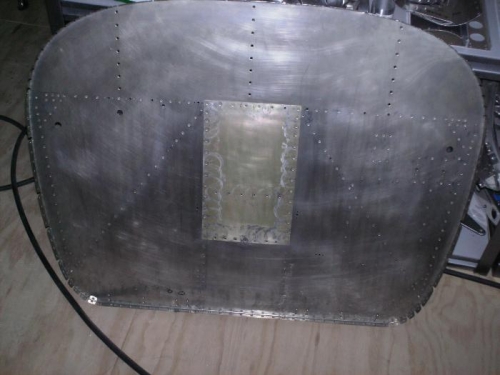

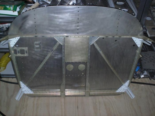

Firewall
Finally got teh firewall reassembled with the aluminum alodine treated and AN rivets installed. The previous "Builder" and I use that term loosely had the thing assembled with pop rivets, even in the structural areas.
