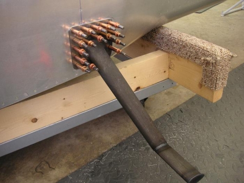

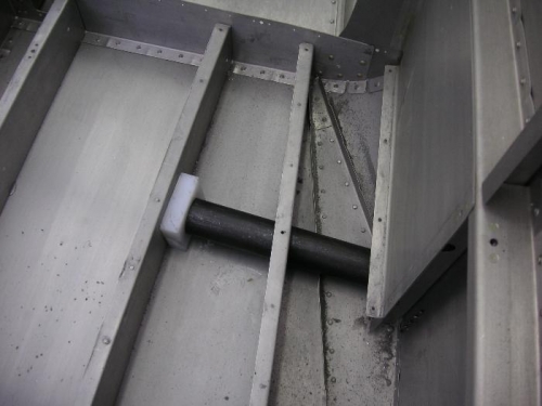

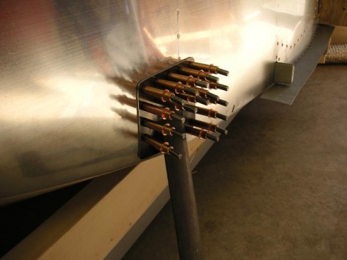

I used a 1.5" hole saw and an extension to cut the holes in the fuselage. They have to be enlarged to get the flat plates to rest against the fuselage properly, so a larger size would be fine. I haven't ddecided yet wheather to use pulled or driven rivets. Both came in the step package.
left step
left step
right step
right step
internal mount
internal mount
