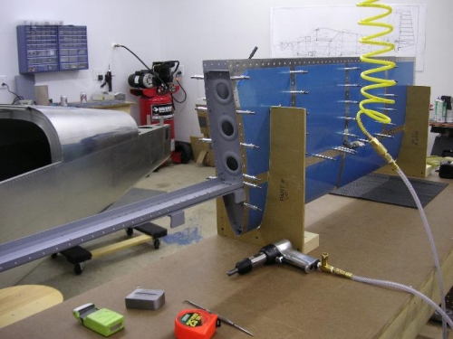

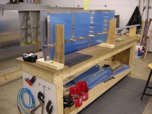

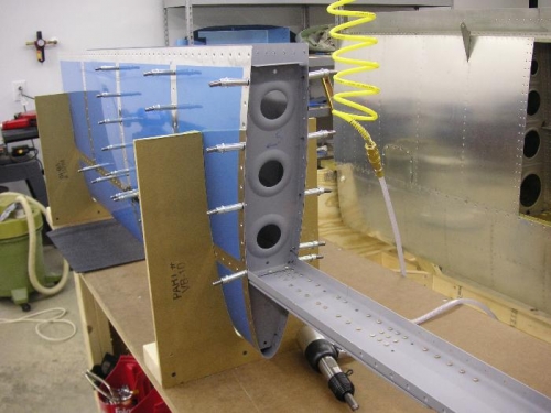

Brief Description:  Ready to rivet skins
Check the sequence! It's easier to rivet the inboard main and nose rib to the spars before you place them in the skins. If I were doing it again I would rivet these ribs before I did the brackets. It would be even easier. Lots of documentation on the web for the change in order.
ribs riveted to spar
Don't follow the sequence shown in the Orndoff videos
