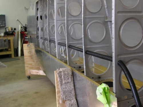

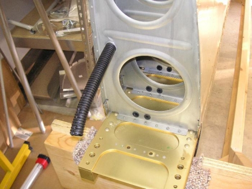

Brief Description:  Drilled wings and installed Van's wiring conduit
Used a step drill on an extension to drill through the wing walk areas. Marked with a template and pilot drilled with an 18" X #40 drill first. Pulling through the wing walk area was a pain! Also drilled out tooling holes on the right wing for additional snap bushings.
Added Conduit to both wings
