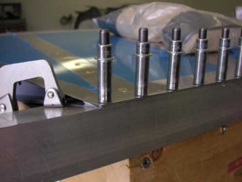

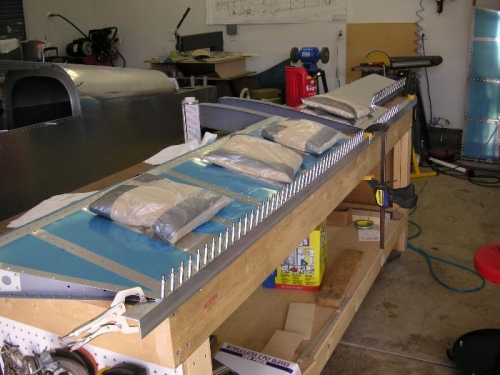

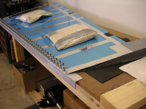

I did all of the trailing edges at once
The double flush rivets get installed after the Pro Seal sets. I probably won't get to it till next weekend. I'll start on the trim tab next.
Left and Right Elevators
I clecoed everything down to an AL angle to keep it straight.
