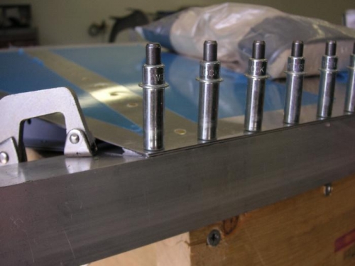

Brief Description:  Pro Sealed AEX Wedge to elevators and rudder TE

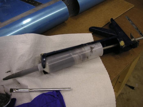

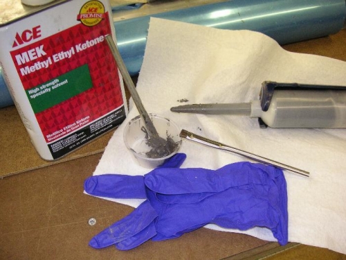

This is the stuff you need to close the trailing edges, Nitrile gloves, MEK, Pro Seal, acid brushes with the half bristles cut off and lots of rags!Pro Seal is incredibly sticky stuff, but the MEK cuts it easily. I wore several pairs of gloves so I could just take a pair off if they got too much on them.A cheap caulking gun worked well with the Pro Seal cartridge. I did have to grind down the plunger to a slightly smaller diameter. If I were doing it again I would buy the smaller containers. I threw away 2/3 of this cartridge.
Nitrile gloves,
Nitrile gloves,
I threw away the cheap caulking gun. The pro Seal is so sticky I couldn't get the plunger out.
