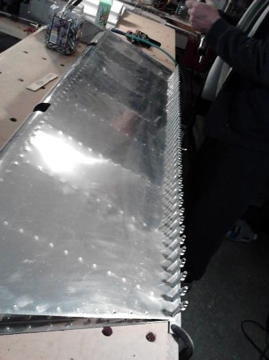

Brief Description:  RH elevator trailing edge setup and drilling
Finally got around to beginning the trailing edge work on the RH elevator. As for the rudder, had to buy some aluminum angle to maintain straightness as I match drilled from the top side holes thru the AEX wedge, the bottom side (which has no holes) and through the angle. Wasn't as tricky as I had feared (and procrastinated over!). Made that little drill guide in the drawing from a paint stirring stick. Tedious but satisfying to have done. Let's see. I only have to do this same procedure for 5 more control surfaces! All right!.
Drilling
Drilling
