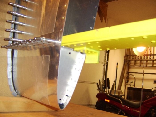

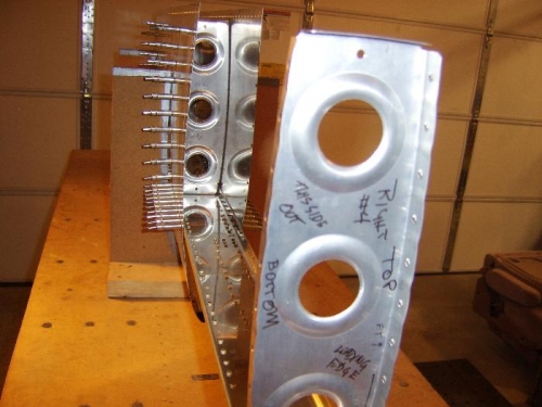

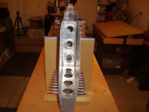

Brief Description:  HS Inboard Ribs to Front Spar and Fitting to Skin
Riveted the four inboard (but non-middle front) ribs to the front spar. Placed the right half HS skin with the already riveted front ribs into the cradles again and fit the spar into place. Clecoed skin to spar and inboard ribs to skin in preparation for inserting and riveting the remaining ribs.
Center Doubler and Mounts
Exposed Left Side Inboard Ribs
From Right Tip Toward Center
