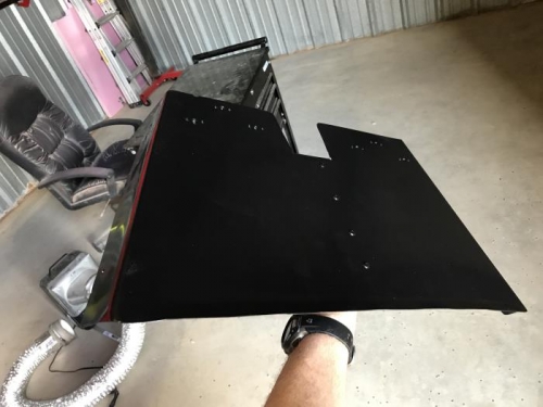

Brief Description:  Cooling Exit Air
Finally!! In spite of all my attempts to make a "sleeker" design, the long term cooling issues I've been having has finally been solved with a dropped lower cowl with a 2" lip to create sufficient low pressure. Turns out I just needed to provide more exit area to get things flowing. What about the drag? Apparently it is only visual, I have not noticed any difference in cruise and top speed. So there you go, once again it would seem that you just can't eye fluid dynamics !!
top side
top side
bottom side
bottom side
